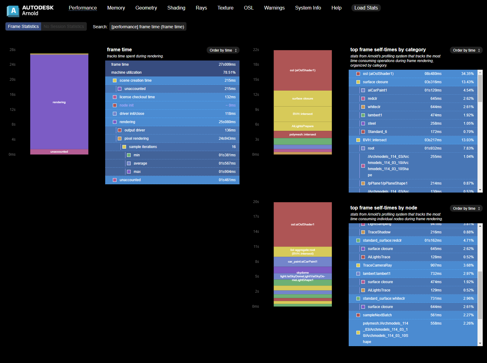

  • Arnold for Maya now includes live Render Reports in the Arnold Render View.

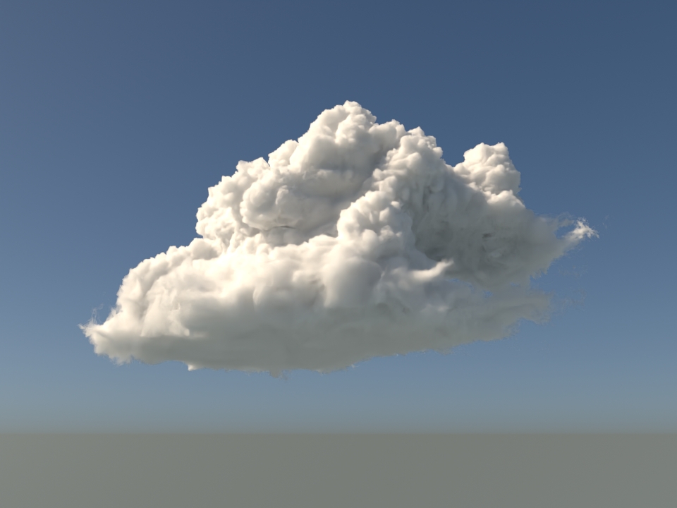

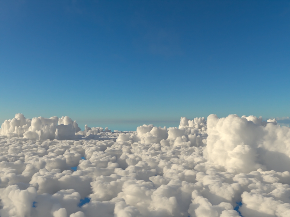

Support for mip-mapped OpenVDB files on CPU
The volume node now accepts OpenVDB files with mip-mapped grids. The different mip-map levels are distinguished by _level_N suffixes, where N is the mip-map level. Arnold then automatically chooses the appropriate mip-map level during rendering, which gives substantial speedups in volumes with a lot of scattering (for example, clouds) in exchange for mostly small differences in look. Volumes with more mip-map levels can have larger differences in look. Users can also specify mipmap_bias on a volume node or on its instance (by declaring user data of the same name), which adjusts the automatic mipmap selection by that amount. (ARNOLD-14453, ARNOLD-15056)
You can generate mip-mapped volumes either with the Arnold API, or with kick. The Arnold API includes a new AiVolumeFileMakeLODs function. kick has a new -makevolumelods command-line flag. Both the API and the kick flag take three arguments: the input file, the output file, and the maximum number of levels to generate. The actual number of levels generated maybe lower than the number requested. (ARNOLD-16921)

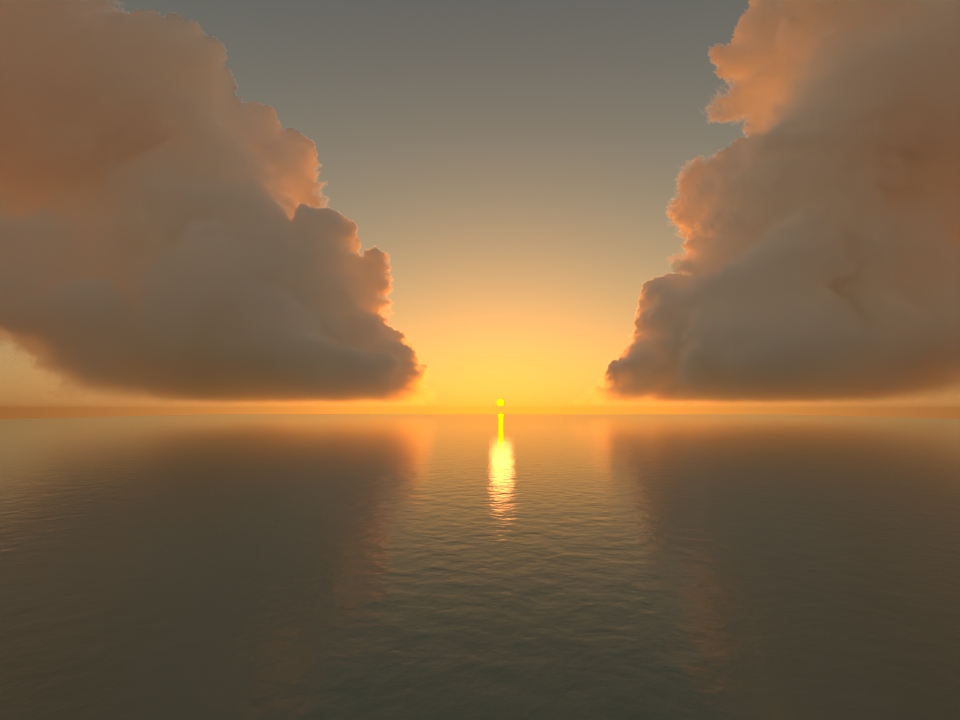

wdascloud byc-cloud composition 1 composition 2 sunset clouds
original volume
mip-mapped volume (3 levels)
Speedup 1.5x 1.9x 2.6x 2.1x 1.8x
mip-mapped volume (6 levels)
Speedup 2.0x 2.8x 5.2x 3.2x 2.7x
Improved GPU volume rendering performance
GPU rendering of volumes is up to 3.5x faster. (ARNOLD-8936)
Speedup 2x 1.12x 3.7x 3.5x 1.31x

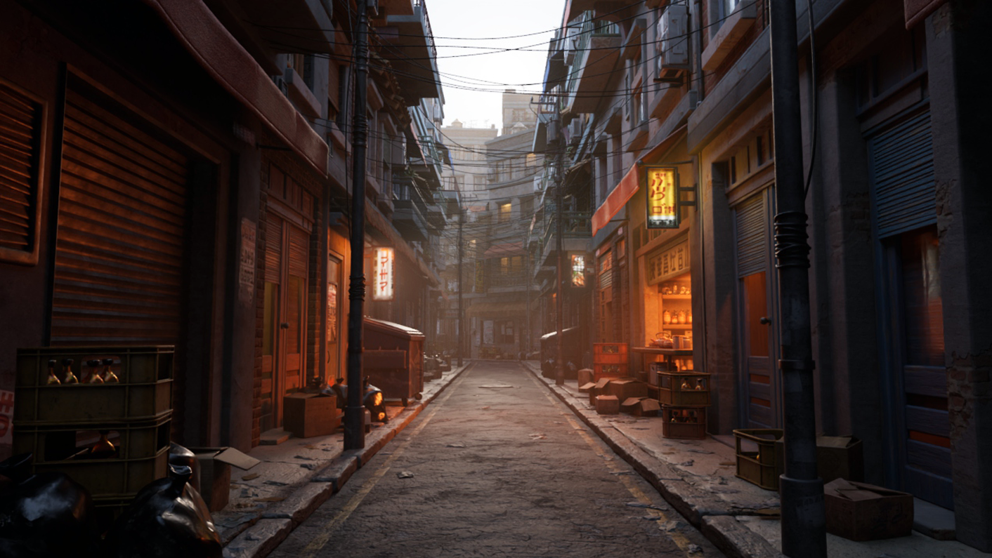

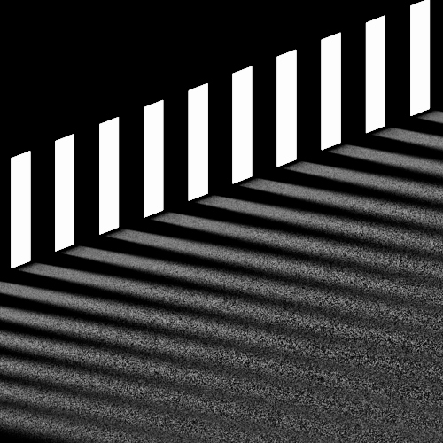

Increased Global Light Sampling (GLS) robustness and added support for light spread
GLS is now more robust, and GLS takes the spread parameter of quad and disk lights into account. This typically reduces noise when lights have a narrow spread, or the spread is close to the light edges. We have observed up to 6x faster renders in some test scenes with especially tricky lighting. In the below back-alley scene, which has a more common lighting setup with some lights with a spread, this gives a 1.4x-faster render. (ARNOLD-13684, ARNOLD-16610 and ARNOLD-16551)
1.4x faster than 7.4.3
7.4.3.2 7.4.4.0 (same number of samples as 7.4.3.2)

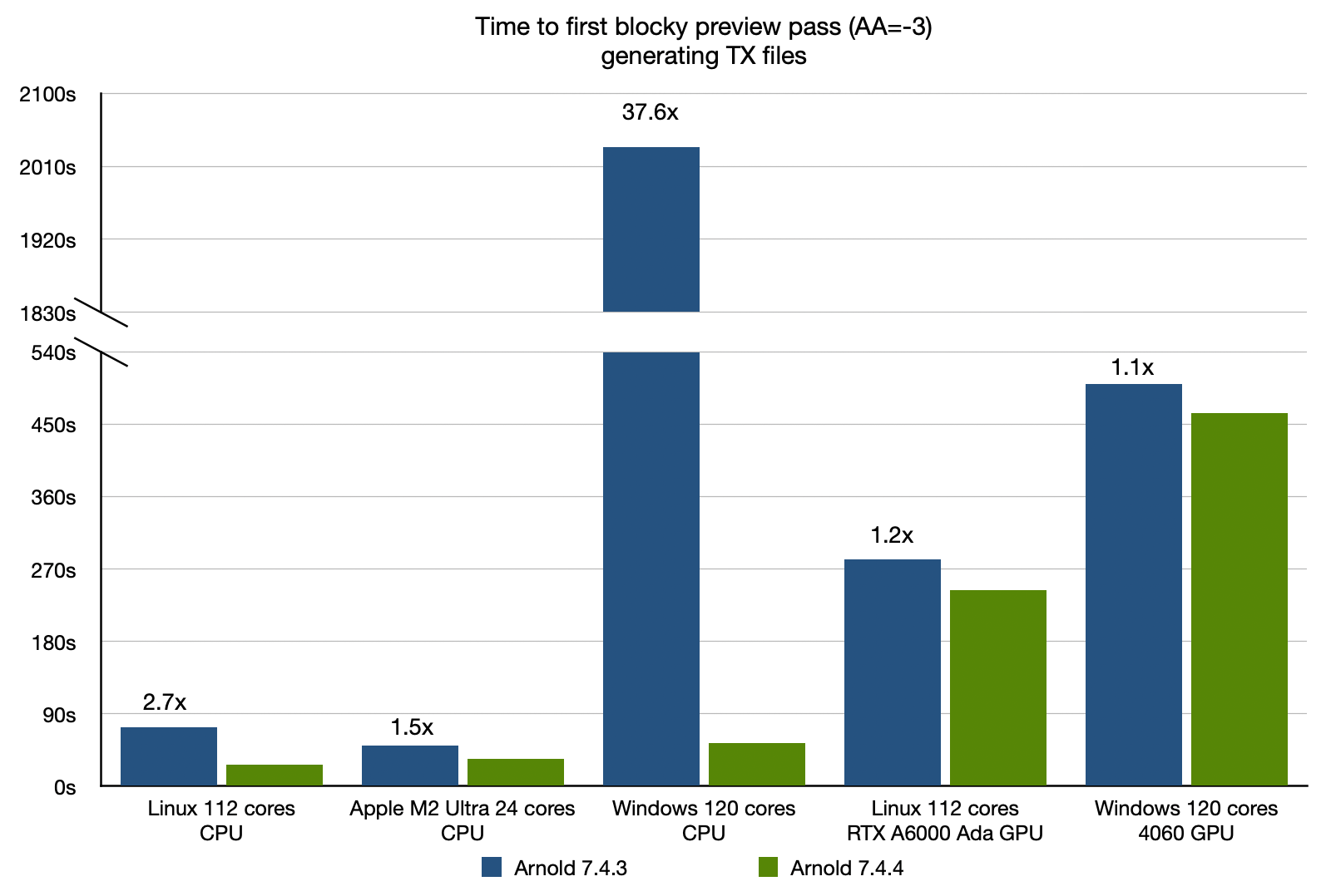

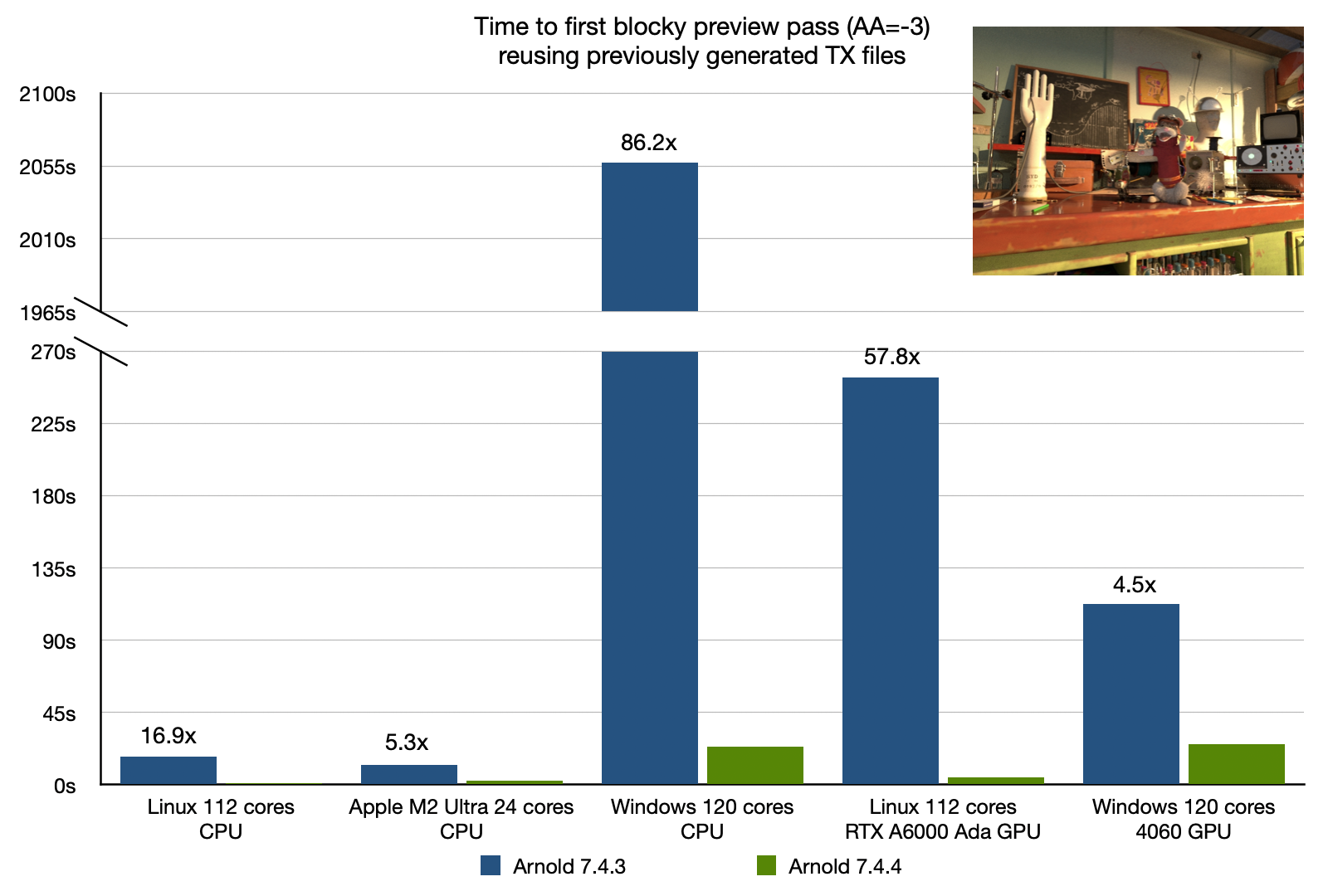

Improved performance when auto-generating or using existing TX files
Checking for existing TX files and auto-generating missing ones is now significantly faster, reducing time to first pixel when using texture_use_existing_tx or texture_auto_generate_tx. As the charts below show, speedups are most pronounced on many-core machines, particularly on Windows. (ARNOLD-13116)
texture_auto_generate_tx speedup texture_use_existing_tx speedup

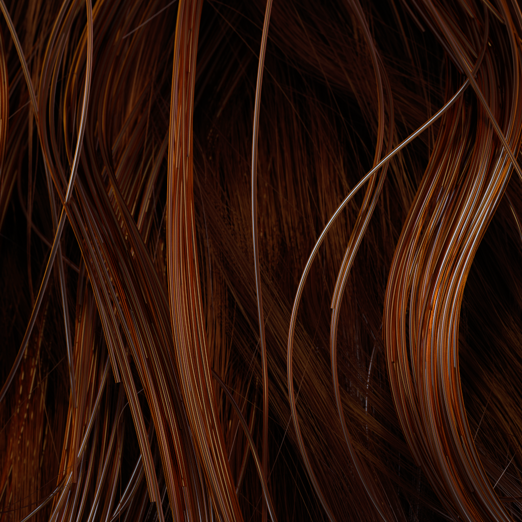

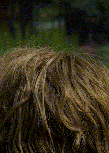

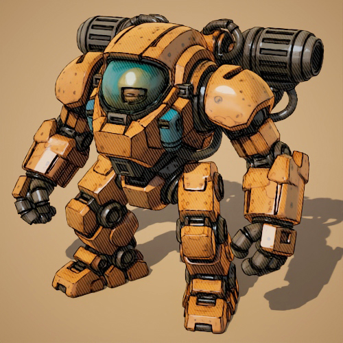

Scattering mode for standard hair
A scattering option scattering_mode has been added to the standard hair shader. Use the approximate mode to get the previous behavior. The accurate mode can be noisier, and so takes about 10 to 30% longer to render, but delivers more realistic results, especially in close-ups, by simulating each hair as a cylinder instead of flat surface. The adaptive mode uses the accurate mode for close-up hairs and the approximate for far-away hairs, automatically balancing quality and performance. (ARNOLD-16726, ARNOLD-16852)
approximate accurate approximate (closeup) accurate (closeup)
adaptive

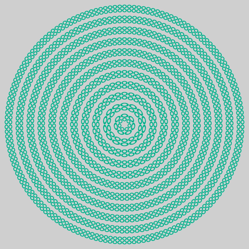

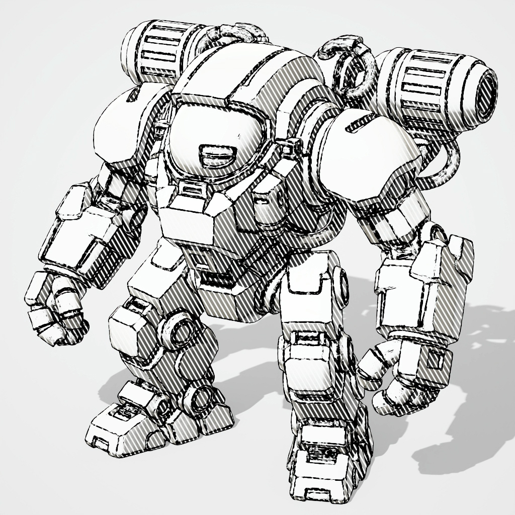

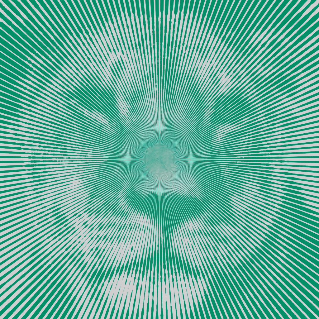

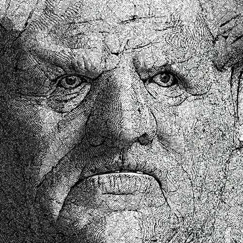

Line shader
Line → UV Transform (screen space) Line → UV Transform (screen space) Line → Triplanar
The new line shader renders lines in various styles to create geometric patterns or brush-stroke-like textures when combined with noise and textures. You can generate complex hierarchical patterns by connecting line shaders together. We recommend using the line shader with uv_transform. (ARNOLD-14976)

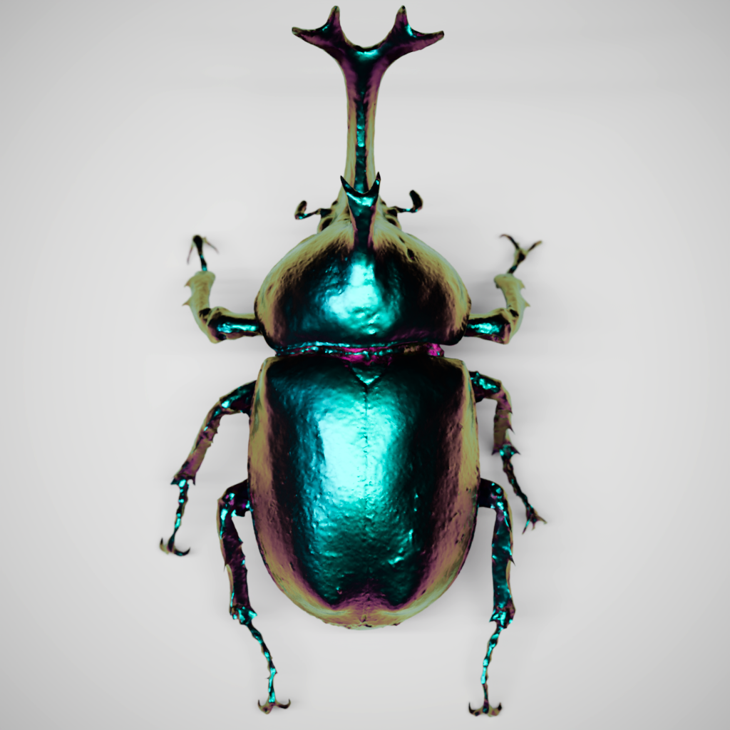

Improved OpenPBR Surface thin film
Thin film is now more physically correct, with improved energy conservation. Note that this may produce a significant change in hue in existing assets. Note also that this change has not been applied to the Standard Surface shader, for backwards compatibility. (ARNOLD-15981)
7.4.3 7.4.4

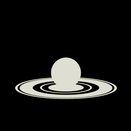

Sampling mode for lights
Lights have a new sampling_mode Enum parameter which controls the type of sampling used for that light. In the default auto mode, the light is either sampled according to the global light samples render options if enabled or the local sample settings. In local mode, the light is sampled according to the light's samples and volume samples parameters, and will be sampled separately from lights that are covered by global light sampling. Local mode helps to make sure that important, hard-to-sample lights receive enough samples. (ARNOLD-13467, ARNOLD-16746)

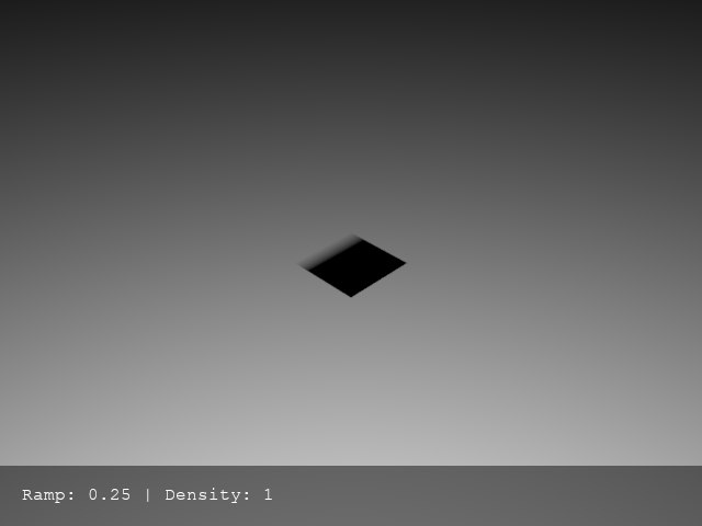

Light blockers with negative density
Light blockers with ramps and negative density values are now supported. (ARNOLD-16338)
7.4.3 7.4.4

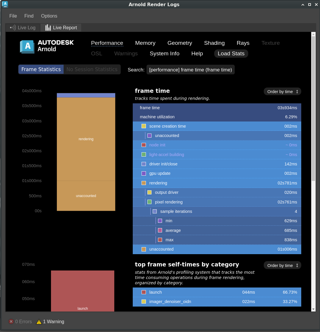

  • Render Reports in Arnold Render View log window: Live render reports are created by default as a new tab in the Arnold Render View log window.

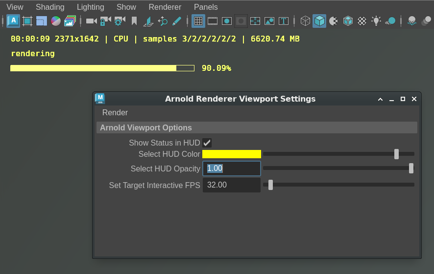

  • Opacity and Interactive FPS added to the Arnold Viewport HUD: In the Arnold Renderer Viewport Settings, you can now set the opacity of the HUD, and control the target interactive FPS for updates. (MTOA-2524)

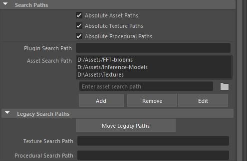

  • New Asset Search Path editor: A new editor for a unified path for discovering assets such as textures and procedural source files (ASS, USD, ABC). Previous search paths are still supported but moved to a Legacy Search Paths section. (MTOA-2512)
Arnold Render View and Arnold Viewport Renderer have a new FPS setting
A new option is available to set the maximum frequency to update an interactive render. (MTOA-2570, ARNOLD-17011)

Better backfacing normal
Interpolated normals facing away from the camera could produce darkening artifacts on low‑poly meshes. Such normals are now bent toward the view direction to prevent this. (ARNOLD-6993)

Render Reports
  • Options node included in JSON statistics: The optionsnode parameters are now written to the JSON statistics file, making it easier to understand what render settings were used when you analyze performance data. (ARNOLD-8558)
  • Consistent unit rounding in Render Report: The Arnold Render Report now rounds values to a consistent unit, improving readability and comparability. Previously, different statistics could be displayed in mixed units (for example, sometimes in milliseconds and others in seconds), which made comparisons difficult. (ARNOLD-17036)
  • Separate statistics for frame and session data: During interactive renders, Arnold now tracks two types of statistics: per-frame for individual frame renders and per-session for accumulated values normalized across the entire render session. The log outputs statistics for each frame in addition to the session statistics, while statistics JSON files contain the final frame statistics and session statistics. This separation helps a user analyze both the performance of individual frames and the overall render session. (ARNOLD-16735)
  • Render Report: enhanced statistics visualization: The Arnold Render Report now displays both per-frame and session statistics during interactive renders. Additional improvements include stacked bar graphs for better visualization of these statistics and other user experience enhancements. (ARNOLD-16736)

  • Unify search paths: Procedural and texture search paths are now unified into a new asset_searchpath. LUTs for the tonemap imager also use this new search path. (ARNOLD-16486)

  • ARNOLD-16833 - Render Report displays milliseconds 10x too small

  • ARNOLD-16862 - Render Report: pixel rendering sample iterations are output as microseconds
  • ARNOLD-16868 - Render Report: warning page incorrectly defaults to performance page
