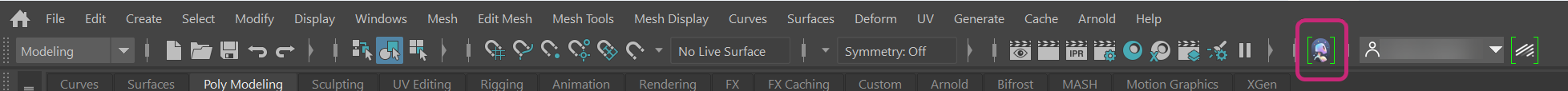

You can access Autodesk Flow Studio from inside Maya using the dedicated button in the Status Line (next to the Sign in dropdown).

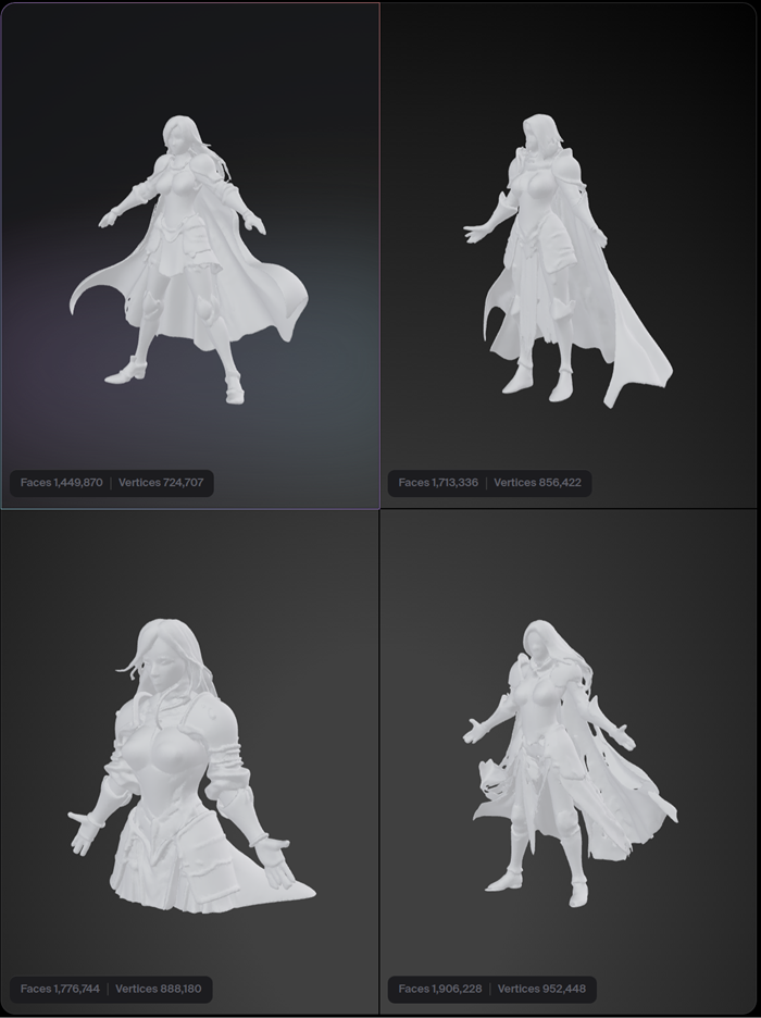

  3. Enter a seed value. You can change this value on subsequent attempts to get more variations of the output.
  4. Click Generate Mesh.
  5. Once you've found an acceptable variation, select it and adjust the options. For the best deformer compatibility in Maya, make sure to set Topology to Quad.
  6. Click Generate.
  7. When Flow Studio completes the mesh generation, select it and download either the USD or OBJ version of the file.

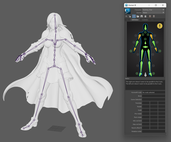

Once you've imported the geometry into Maya, you can modify it using any of Maya's native tools. If you imported a bipedal character, you can quickly rig it using HumanIK.
Note: Even if the bind pose isn't perfect, you start with a default HumanIK example, then move and rotate the joints to fit your character before skinning.

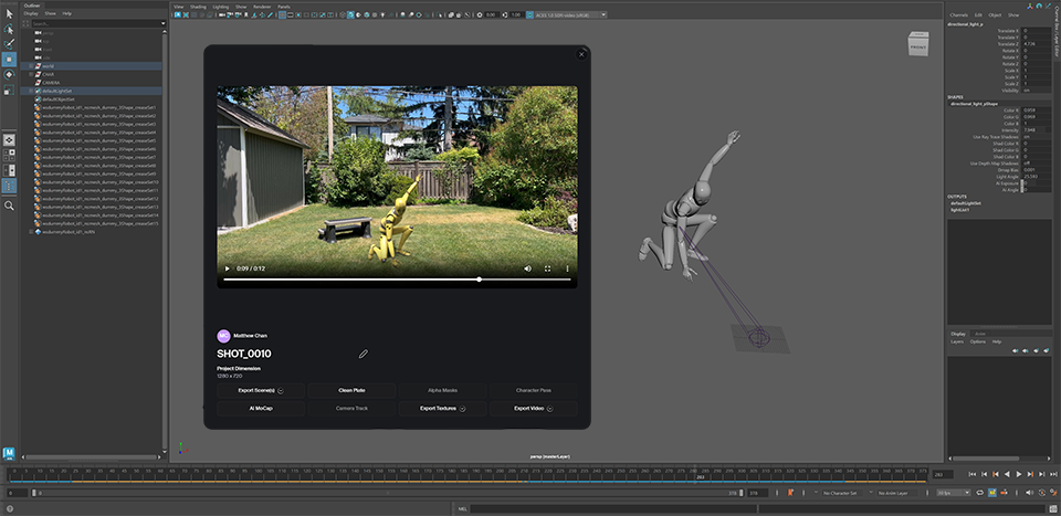

  1. Follow these steps to produce a 3D scene from a camera recording using Live Action Easy, Live Action Advanced, or Animation / Video to 3D Scene.
    • In the Export Scene settings, make sure to enable Maya Scene (optionally, you can output as USD as well).
    • (Optional) Export Camera Track if you'd like to maintain the same camera movement in your 3D scene.
  2. Once Flow Studio is finished generating the animation, download the .zip file and extract it, then open the .ma file.

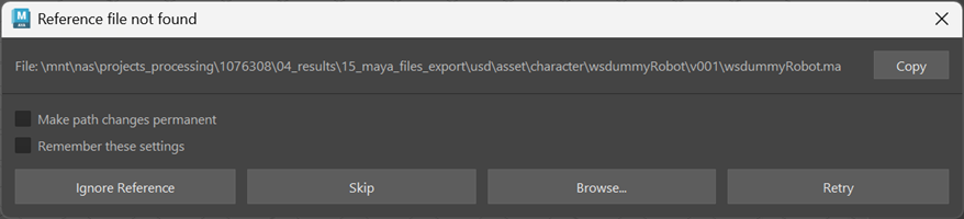

    Note: If Maya displays a warning that file references are broken, you can manually update the paths using the dialog that appears (for example, the character rig can typically be found in the usd > asset > character folder).

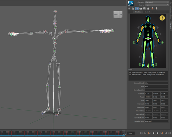

  2. Once Flow Studio is finished generating the animation, download the .zip file and extract it, then import the mocap data (FBX or USD).
For imported mocap data, the last frame of the animation will contain the mocap skeleton in a T-Pose, which you can use to either define a HumanIK rig, or retarget to your own custom rig.
