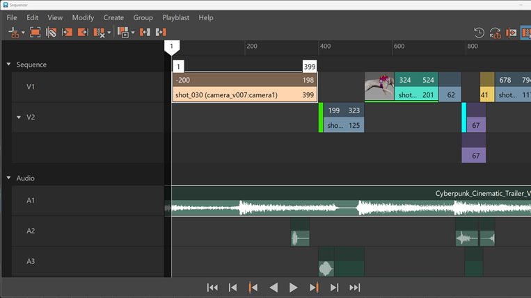

Expanded shot organization tools
Sequencer now provides additional visual tools to organize shots:
Shot Labels
  • Create labels with custom names and colors.
  • Assign a label to a shot.
  • Manage labels using the Label Manager.
  • Label names appear as tooltips when hovering over a shot.
Shot Colors
  • Assign custom display colors to shots.
  • Choose from preset swatches or define custom colors.
Custom Shot Thumbnails
  • Load a custom thumbnail image for any shot.
  • Thumbnails appear in the upper-left corner of the shot.
  • Remove thumbnails at any time.
These tools improve clarity when working with complex sequences.
