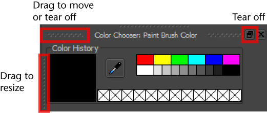

When the interface is unlocked, all tools and windows update to display the following layout controls:
- Do any of the following to rearrange the interface:
- To tear tools off, drag the double dotted line
or click
, and either drop them on the 3D View to create a floating window, or drag them to dock in a new location. (A white outline displays to indicate where the window will snap when dropped.) - To create a tabbed layout, drag tools on top of each other.
- Close any windows or tools you don't want. Tip: To reopen closed tools, right-click any double-dotted line
to select from a list of available tools. - Resize tools by dragging the single dotted lines
