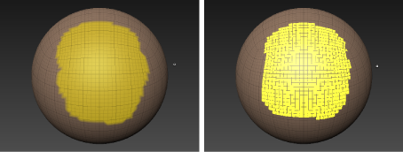

  1. Select the Faces tool on the Select/Move Tools tray.
  2. Select faces on the mesh you want to delete.
  3. Press Delete or select Edit > Delete Selected.
  4. Tip: You can set whether selected faces display with a soft falloff using the Render Selected preference (in the Render preferences section of the Preferences window).
