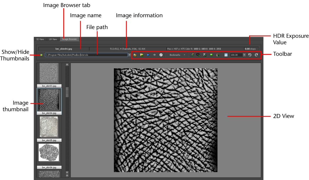

Image Browser window
The Image Browser lets you select, view, and evaluate 2D images and textures located on your local hard drive or network.
You can drag and drop images from the Image Browser, for example to copy them into your system file browser or the Color Chooser window. (See also Sample color from an image.)
To display the Image Browser, click the Image Browser tab at the top of the 3D View, below the main menu bar.
Display the Image Browser. A variety of image formats and bit depths are supported. In addition, you can use the Image Browser to:

Image Browser task overview
To: Do the following:
View an image using the Image Browser.
In the toolbar, click Open Directory , select a directory, and click OK.
The contents of the directory display in the Thumbnail View. (Only valid image files and file directories display in the Thumbnail View.)
Click an image in the Thumbnail View to display it in the 2D View.
Determine information about the image displayed in the 2D View (for example, resolution, bit depth).

Image Browser toolbar
Hide List of Thumbnails
Hides the thumbnail list.
Open Directory
Opens a file browser, letting you select a directory to browse in the Image Browser.
Parent Directory
Moves to the parent directory of the current directory.
Back
Goes to the previously browsed directory.
Forward
Goes to the next directory in the browser history.
Refresh Thumbnails
Refreshes the thumbnail images.
Bookmarks
Lets you create browser bookmarks for quick access to specific directories.
Set Stamp
Applies the current image as a stamp for the current brush.
Set Stencil
Applies the current image to the current stencil.
Set Image Plane
Applies the current image to the image plane of the current camera.
See Negative As Flat Color
Clips negative values in 32-bit float maps and displays them as a flat color.
Refresh Image
Reloads the main image.
Scale To Fit
Scales the main image to fit the browser window. Scale To Fit can be set so it remains on for all images displayed in the view.
Image Zoom Ratio
Sets of the zoom amount for the image display.
Rotate Counterclockwise
Rotates the image counterclockwise by 90 degree increments.
Rotate Clockwise
Rotates the image clockwise by 90 degree increments.
