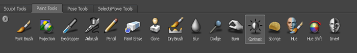

  2. In the Paint Tools tray, select the Contrast tool.
  3. In the Contrast tool properties, set the Contrast property to either increase or decrease the difference between light and dark pixels.
