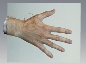

You can place an image plane so that it overlays your work and acts as a reference while you sculpt or paint.

    The image appears in the center of the 3D View in front of the model (provided that the camera is selected and the 3D View is set to look through it).

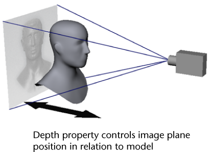

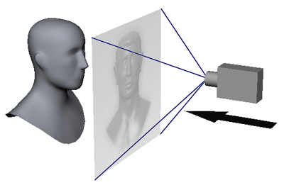

  • To adjust the depth position of the image plane so it appears either in front, behind, or intersects the model, adjust the Depth property.
