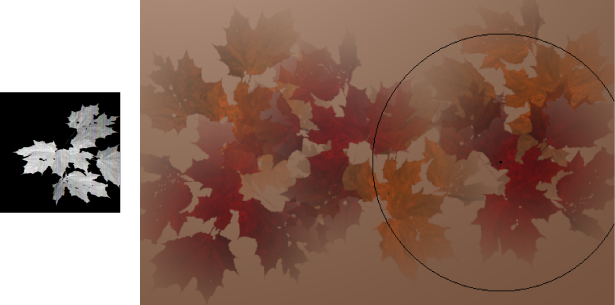

You can load images into the Paint Brush and use them as color stamps. Painting the model with a stamp is like painting a decal or tattoo directly on the model. That is, each time you click the model with a stamp loaded onto the Paint Brush, the image is applied to the model.
You can produce an infinite variety of paint brush effects based on the combination of bitmap images and brush property settings.
Note: Images for stamps and stencils can be 8, 16, or 32 bits in depth. For more information on creating your own stencils and stamps, see Saving images for stencils and stamps.
