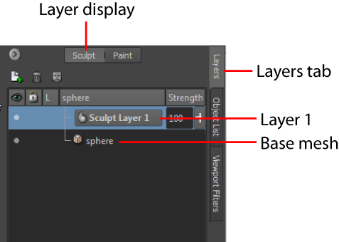

  1. Click the Layers tab in the upper-right corner of the Mudbox interface to display the Layers window.
  2. To create a new sculpt layer, first set the display button at the top of the Layers window to Sculpt, then click the Layers window menu () and select New Layer from the list (or click the New Layer icon ).
    A new layer called Sculpt Layer 1 is created and becomes the active layer. Mudbox stores everything you sculpt on this layer until you select another layer or change subdivision levels.

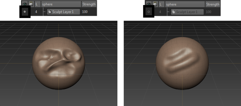

  4. To sculpt on the original base layer (Sphere), click the Sphere layer in the Layers window to select it.
  5. Turn off the display of Sculpt Layer 1 by clicking the visibility icon (a dot in the Visibility column ).
    The details you sculpted on Sculpt Layer 1 disappear when the layer is invisible.
You can lower the Strength setting (next to the layer name) to non-destructively (temporarily) fade out the sculpting for the entire sculpt layer. The Strength value also works as a multiplier; you can either amplify or invert the sculpted information on the layer by entering values over 100 or by entering negative values.

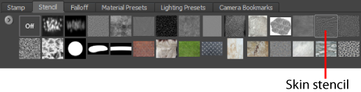

  4. In the Stencil tray, select the bw_skin08.jpg thumbnail image. (Place the cursor over a thumbnail image to display its name).
    The stencil image appears in the center of the 3D View.

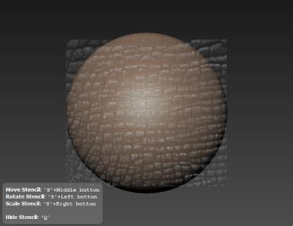

  5. Ensure the sphere is positioned directly behind the stencil image in the 3D View.
    Use the following hotkeys if you need to reposition the stencil in the 3D View:
    To:
    (Windows and Linux)
    (Mac OS X)
    Rotate a stencil S + drag S + drag
    Move a stencil S + Middle-drag S + Middle-drag
    Scale a stencil S + Right-drag S + Right-drag

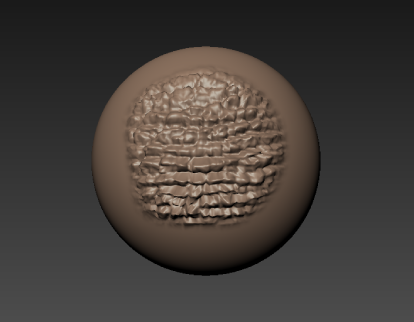

  6. With the Sculpt tool still selected, stroke across the stencil image and onto the sphere.
    The stencil disappears as you stroke to let you view the affected region on the model.
