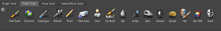

- In the Paint Tools tray, select the Paint Brush.
- Stroke on the model to paint.
