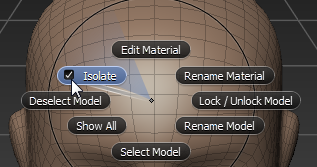

Model marking menu
Right-click a model for quick access to these marking menu options.
Edit Material
Opens the Properties window, displaying the Material properties.
Rename Material
Opens a dialog box that lets you enter a new name for the material.
Lock/Unlock Model
Lets you lock and unlock the model as you work, preventing you from accidentally editing, moving, or sculpting it as you work elsewhere in the 3D View. See also Lock a model.
Rename Model
Opens a dialog box that lets you enter a new name for the model.
Select Model
Selects the model. See also Select and move items.
Show All
Shows all previously hidden faces and meshes in the scene. (Hotkey: U)
Deselect Model
Isolate
Temporarily hides all but the active or selected object(s), letting you quickly limit what displays in the scene. This toggle also displays in the Display menu.
The Isolate toggle works with other show/hide options, so that any hidden faces or objects remain hidden as you toggle in and out of the Isolate display.
See also Isolate faces or models.
