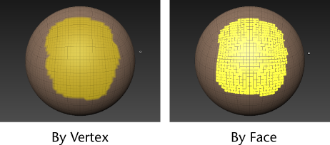

- Render Selected
Lets you set whether selected faces display with a soft falloff or not. Select from the following options:
- By Vertex
Displays selected polygon faces with a soft falloff around the selected area.
- By Face
Displays selected faces with no falloff, so faces clearly display as selected or not.
