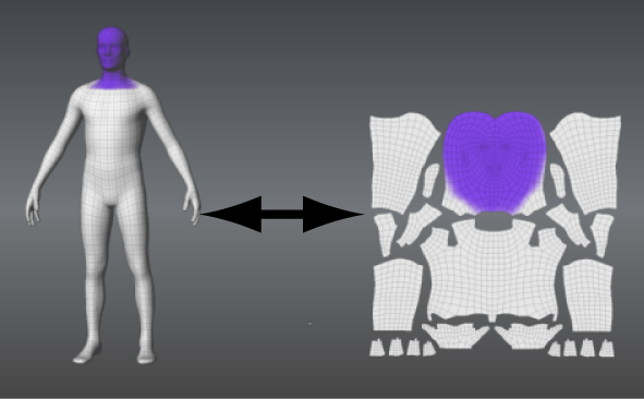

In some cases, it’s useful to paint on a flattened version of your model (as it appears in the UV View).
Flatten to UV Space (Hotkey: Alt + T) lets you paint on a flattened representation of the mesh, within the 3D View.
Flatten to UV Space creates a copy of the selected model with vertex positions that are identical to the UV texture coordinates of the original 3D model, so you can paint or edit your textures on the flattened version. The original model is temporarily invisible to let you paint on the 2D copy.
When the model is laid out flat, it’s easy to see how the painted textures correlate to the UV shells, without having to switch to the UV View.

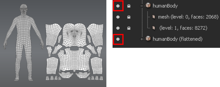

    Tip: Both versions of the model (3D and 2D) reference the same texture map and can be displayed and painted simultaneously in the 3D View. To display the 3D model along with the flattened version, enable the Visibility icon for the 3D version in the Object List.
    Now you can paint on either version of the model and the associated texture maps update automatically.
