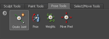

  1. In the Pose Tools tray, select the Create Joint tool.
  2. Position the Create Joint tool cursor over the model so it displays as a dot, then click-drag on the model where you want the joint to appear. Two items appear when you drag:

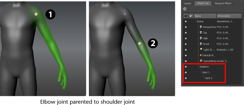

    As you create additional joints, Mudbox automatically organizes the joint objects under a Skeleton object in the Object List. The hierarchical structure of this skeleton is determined by your placement of joints.
    A smart auto-hierarchy logic creates joint hierarchies based on the influenced vertices as follows:
    • If you create a new joint with an area of influence that is completely inside the area of influence for an existing joint, the new joint is parented to the existing joint.
    • If you create a new joint with an area of influence that completely subsumes the area of influence of another joint, the new joint becomes the parent of the subsumed joint.
    • If you create a new joint whose area of influence is completely outside the influence area of other joints, the new joint is added as a sibling.
    For example, if you create a shoulder joint with a weighted region on the whole arm, then create a joint at the elbow and drag to establish weighting toward the wrist, the elbow joint is auto-parented to the shoulder joint. A bone object displays between the two joints to indicate this relationship.

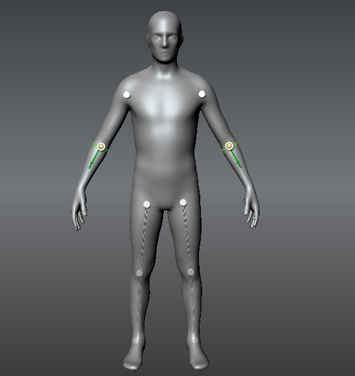

To create symmetrical pairs of joints
  1. Select the Create Joint tool in the Pose Tools tray.
  2. In the Properties window, do the following:
    • Ensure the One Joint At A Time option is turned off.
    • Set the Mirror option to the desired axis of symmetry you want joints copied across.
  3. Click-drag on the mesh to create a joint, dragging to indicate the area of the mesh you want the joint to influence.
    One joint is created where you click, and another joint is created on the opposite side of your selected axis of symmetry.
