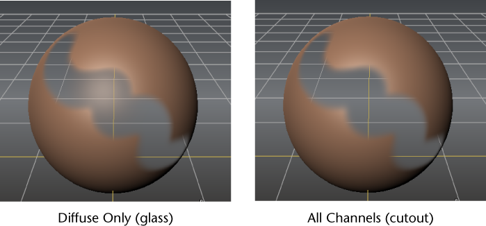

- Opacity Affects
Specifies how opacity affects lighting effects. There are two options:
- Diffuse Only
Opacity overrides only the diffuse channel, allowing the transparent surface to continue to show reflections, specularity, bump, and so on. Use this option to create the effect of a transparent material like glass or clear plastic.
- All Channels
Opacity overrides all channels, causing the surface to effectively disappear. Use this option to create the effect of a hole in your model.

- All Channels
