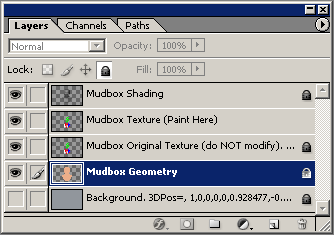

    In Photoshop, the Layers window (Hotkey: F7) contains five layers exported from Mudbox (listed in order from bottom to top):
    Expand here for more information on each layer exported from Mudbox.
    • Background (Locked)
      Contains an image of the 3D View background and camera information. The numerical string listed after the layer name records camera position information used to set 3D View back to its exact location when you re-import the .psd file after editing in Photoshop.
      Danger:
      Editing the numerical string after the layer name or the image on the background layer prevents the texture from aligning correctly when the .psd file is re-imported to Mudbox. Do not resize the 3D View in Mudbox between export and re-import of the .psd file.
    • Mudbox Geometry (Locked - Do not modify.)
      Contains a screen capture of your model(s) as it appeared in the 3D View. It displays a non-shaded (flat shaded) preview of the model with the assigned shading material. Mudbox uses this layer to accurately composite your paint edits when you re-import the file.
    • Mudbox Original Texture (Locked - Do not modify.)
      Contains a copy of the original paint layer(s) as it appeared from the camera at screen capture. Mudbox uses this layer to make a comparison between the original paint layers and any edits you make on the Mudbox Texture layer.
    • Mudbox Texture
      Where you paint or apply any paint edits. These are applied to your model after you save the .psd file and re-import to Mudbox.
      Danger:
      Do not change this layer name. Renaming this layer prevents you from re-importing the file to Mudbox.
    • Mudbox Shading (Locked - Do not modify.)
      Contains a screen capture of the 3D shading of your model(s) as it appeared within the 3D View. Mudbox uses this layer to accurately composite your paint edits when the file is re-imported. It can be useful to keep this layer visible as a reference for your paint edits in Photoshop.
