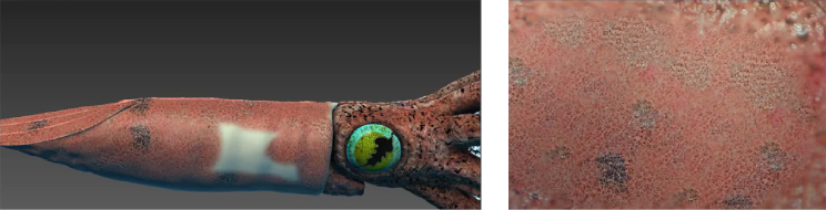

PTEX painting provides a new way for artists to paint texture maps - free from UVs. With PTEX painting, you apply paint to each base face of the mesh, creating high resolution detail without needing explicit UV coordinates.
While UVs provide a way to map your texture from a rectangular image onto a 3D object, PTEX lets you paint directly on the faces of the object itself, no UVs required. You can load and use PTEX painting on any mesh, including complex models composed of multiple meshes. The paint information is associated with the base faces of the mesh.
Once your mesh is set up for PTEX painting (Prepare a model for PTEX painting), creating a new paint layer automatically creates a PTEX paint layer. For an entirely UV-free pipeline, you can export your high-quality textures as PTEX files, or if your pipeline requires UVs, bake your textures to UV space (once UVs have been created) and export them as image files. (See Export paint layers.) When you save a PTEX file, mesh data is also saved by default, letting you easily inspect your PTEX textures in other applications.
