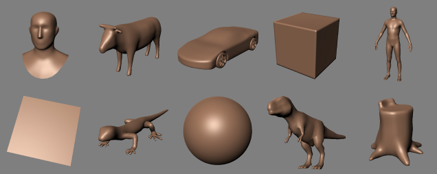

Mudbox includes a variety of pre-made 3D polygonal mesh sculpting templates you can use as the basis for your sculpted models. These simple pre-made polygonal meshes have UV texture coordinates (which are required for texture painting and texture extraction). Pre-made mesh templates include some basic 3D shapes (cube, plane, sphere) and several other organic forms.
To load a sculpt template
  1. From the main menu, select Create > Mesh and select an object type from the list.
    The object appears in the 3D View at the center of the 3D View (origin).
Note: You can add your own models as sculpt templates to the Create > Mesh directory so they are available each time you run Mudbox. For more information, refer to the Mesh Properties in the Create menu.
