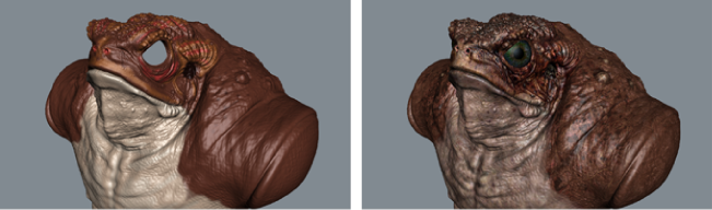

Paint tools in Mudbox let you apply digital paint to your high resolution 3D models. Select a paint brush, create a layer to paint on, and paint your model in the 3D View.
Paint modes
Two paint modes are available:
- 3D Paint: You apply paint directly to the 3D model. Paint appears on the model as you stroke (based on the Paint Brush properties you set). Behind the scenes, Mudbox creates a 2D bitmap image which is saved when you save the model or export the paint layer. (See also Save paint layers and Export paint layers.)
You can also apply images as paint using brush stamps on the model, like a decal or tattoo. See Paint using brush stamps.
- Stencil Projection: You project paint onto the 3D model using a 2D stencil image, applying color from the image as if projected or sprayed onto the model. You position the stencil in relation to the model in the 3D View, then stroke across the stencil where you want to apply the image as paint. See Paint using stencil projection.
Stamps and stencils let you create different effects than using the Paint Brush tool alone.
