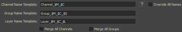

- Channel Name Template, Group Name Template, Layer Name Template
- Lets you specify a naming template to be applied to each saved paint channel, group, and layer.
By default, layers are named based on the template Layer_$M_$C_$L, groups are named Group_$M_$C_$G, and channels as Channel_$M_$C_$C.
You can use wildcard characters listed in the window to specify a naming convention for both the Path Template and Channel, Group, and Layer Name Template fields.
For example, if you export the following three paint layers for a model using the Clay material, the paint layers exported (with the default File Name Template wildcard characters) are named Layer_Clay_Diffuse_Layer1, Layer_Clay_Diffuse_Layer2, Layer_Clay_Specular_Layer3.
- Override All Names
- When on, Mudbox replaces the File Name column name(s) in the tree view with the corresponding Channel Name Template, Group Name Template, and Layer Name Template names.
- Merge All Channels
- When on, Mudbox merges the effect of paint layers in all channels.
- Merge All Groups
- When on, Mudbox merges the effect of all paint layers in the corresponding group, letting you easily export a single image per group. The paint layers appear merged in the exported image file, but remain separate in Mudbox so you can continue painting. See also Export paint layers.
