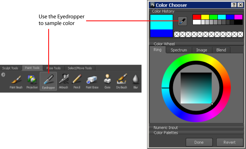

To copy a color from the current paint layer and set it as the Paint Brush color
- In the Paint Tools tray, select the Eyedropper
.The cursor changes to an eyedropper icon.
- In the 3D View, position the eyedropper over the color you want and click to sample.Tip: You can also use the Eyedropper to sample color from an image loaded as an image plane in the 3D View. For information on loading an image plane, see Import a reference image.
The color is sampled and loaded as the color for the Paint Brush. The next time you paint, the Paint Brush applies the copied color.
Tip: To keep the Eyedropper tool active until you select another Paint or Sculpt tool, press the I key as you sample.
Note: Copying a color using the Eyedropper samples the true pixel color, disregarding lighting and shading on the model.
