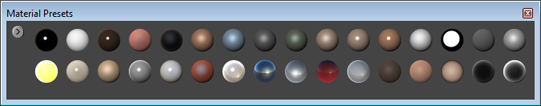

Materials Presets
A number of pre-made materials are available from the Materials Presets tray. Click an item in the tray to apply it to your active model in the 3D View. These can be useful if you’ve never worked with materials before.
