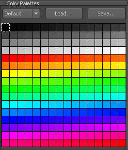

Color Palettes
The Color Palette lets you store up to 256 colors per palette.
  • Click to select a color from the palette.
  • Relocate a color value to another location within the palette by dragging and dropping it on the new location.
  • Right-click a square in the color palette to store any current color.
  • Click Load to load existing color palettes (including those from other applications) or click Save to save your current palette.
  • Select other color palettes from the drop-down menu.
