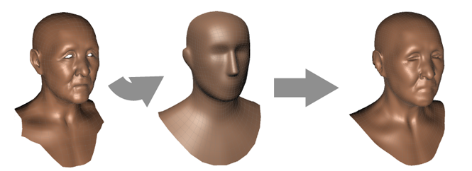

You can transfer properties such as upper level detail, joint weighting, and sculpt layers, from one mesh to any arbitrary mesh, regardless of topology or differing UVs. This workflow is similar to map extraction.
This workflow lets you transfer properties from a high resolution source mesh to a mesh with different topology (target), even if the two meshes have different UV layouts. This can be especially useful if your work has already begun and there are changes to the mesh topology. You can simply transfer details from the existing mesh to the updated mesh.
