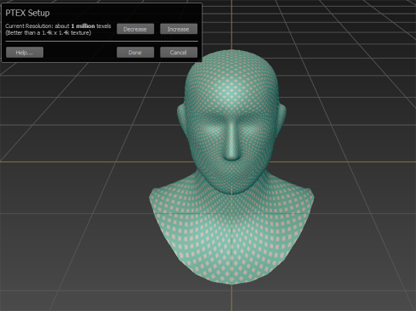

  1. Ensure the model is on level 0, then select UVs & Maps > PTEX setup.
    The PTEX Setup window displays, and a green preview texture displays on the mesh.
    Depending on your setup, either of the following can also appear.
    • If your model has existing paint layers, the PTEX Painting window appears. You can choose to delete existing UV paint layers (click Delete Them) or convert them to PTEX layers (click Convert them to PTEX layers).
    • If this is the first time you've set up a mesh for PTEX, the How to Prepare Your Mesh window appears to give you basic instructions. (Click Close.)
  2. Examine the sample texture on your mesh, zooming and adjusting your view as necessary.
    The sample texture displays to make jagged texture edges as visible as possible, and help you to set an appropriate level of resolution.

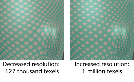

  3. Do either of the following to increase or decrease the base resolution of your model:
    • In the PTEX Setup window, click Increase or Decrease.
    • Right-click the mesh and select Increase Resolution or Decrease Resolution from the marking menu.
    Increasing the resolution makes the display of the sample texture sharper, while decreasing resolution softens the texture but saves texture memory.
  4. Click Done when you're satisfied with the resolution displayed in the sample texture. (You can increase or decrease the resolution in specific areas later.)
