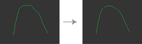

Smooth Curve |
Lets you smooth out bumps or jagged details on the curve by averaging the neighboring points. ![]() Press Shift to temporarily activate the Smooth Curve tool. (Releasing Shift reverts to the selected tool function. |
