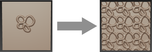

Tiling planes let you quickly sculpt or paint a mesh with a seamless, repeating pattern. You can use tiling planes to efficiently cover large surface areas, or easily extract a texture map of the repeated sculpt detail. Once you've created a tiled texture map, use it as a paint layer or a stencil for painting and sculpting, and delete the tiling plane when you no longer need it.
Image courtesy of Jesus Bibian, Jr.
