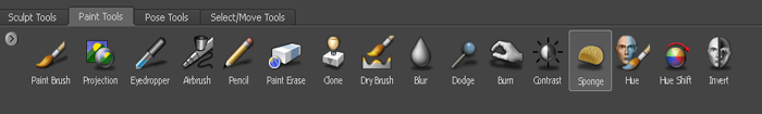

  2. In the Paint Tools tray, select the Sponge tool.
  3. In the Sponge tool properties, set the Amount to increase or decrease the saturation for pixels.
