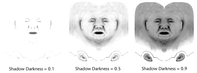

Shadow Darkness
Controls the brightness of the ambient occlusion map. Decreasing the value brightens the resulting ambient occlusion map. Increasing the value darkens the resulting ambient occlusion map. The default setting is 0.5.

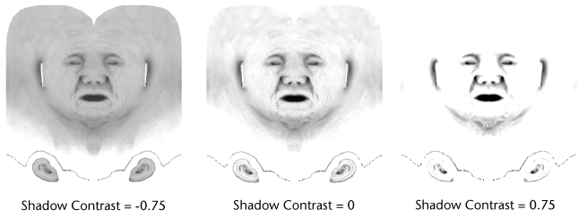

Shadow Contrast
Controls the contrast between shaded and non-shaded areas in the ambient occlusion map. Decreasing the value reduces contrast, producing more mid-tone gray values in the map. Increasing the value increases contrast, producing tones that are more black and white. The default contrast setting is 0 (neutral contrast) with the lower and upper range of -1 and 1.

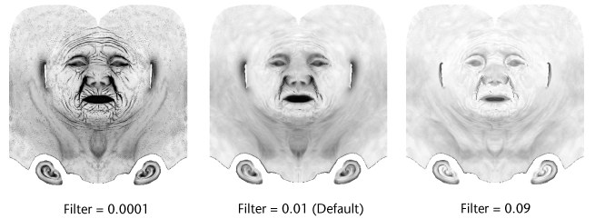

Filter
Controls the filtering of multiple shadow map calculations when producing the final ambient occlusion map. To achieve sharp, finely detailed shadows, set a low value (0.0001). To produce a softer effect, reducing visible artifacts in the map, set a higher number.
