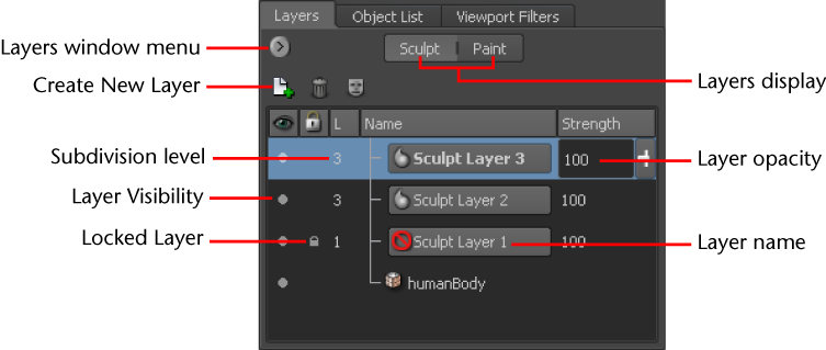

Sculpt Layer menu
Items available from the Sculpt Layers (
) menu:
