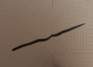

Brush Sample Area
Controls the sample size directly beneath the paint brush cursor. In most circumstances, the default setting of 0 is sufficient.
When painting models with very narrow, thin faces or larger faces relative to the size of the brush tip, visible artifacts can appear. In these situations, try increasing the Brush Sample Area to extend outside the brush cursor to determine the brush effect. For example, a value of 1 doubles the area that is calculated.
Note: Interactive performance of paint brushes can decrease as you increase the Brush Sample Area.

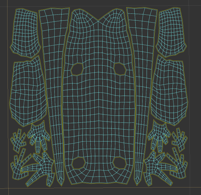

Render Edge Bleed
Render Edge Bleed is on by default, and toggles the display of a yellow border around UV shells in the UV View. This makes it easier to adjust the Edge Bleed border size by providing a real-time visual reference.
UV shells with Render Edge Bleed On

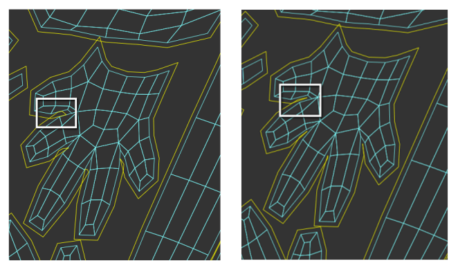

Avoid Edge Bleed Overlap
This setting is on by default. It reduces or prevents the edge bleed from overlapping between UV shells, which helps prevent painting artifacts across faces.
UV shells with Avoid Edge Bleed Overlap Off (Left) and On (Right)
