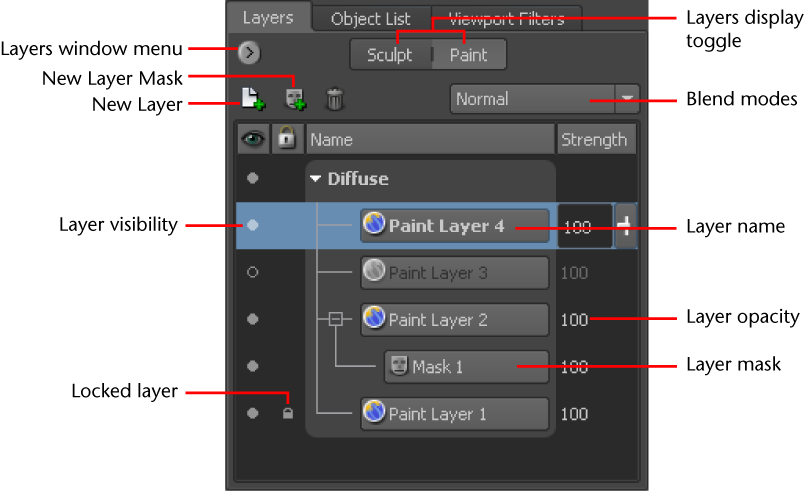

The Paint Layers window lets you create and organize layers of texture information (for example, diffuse color, specular, bump, reflection, and so on) as you paint on your 3D model.

- New Layer
Creates a new layer directly above the selected layer.
- New Layer Mask
Adds a mask to the current layer. See also Paint layer masks overview.

Blend modes
This drop-down list lets you select blend modes on a per-layer basis and affect the appearance of the composite result. For more information, see Blend paint layers and Paint layer blend modes.
