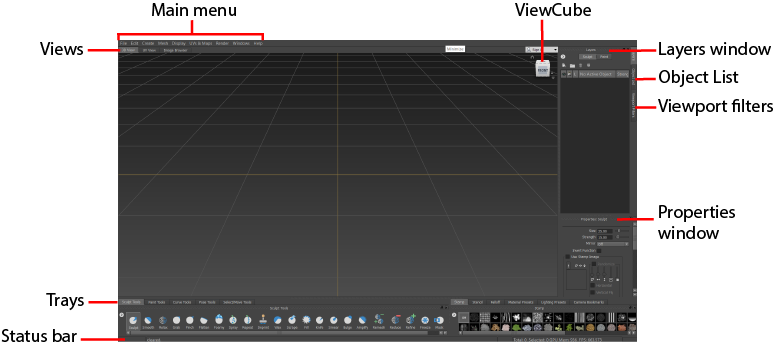

The main areas of the Mudbox interface are summarized in the following sections:
- Main Menu
- Views
- ViewCube
- Viewport Filter window
- Object List
- Layers window
- Properties window
- Trays
- Status bar

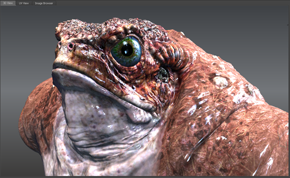

Views
Views provide a location for viewing and editing specific items. Views include the 3D View, UV View, Image Browser, and the Mudbox Community.
The 3D View is the window where you view and work with your 3D models. By default, the 3D View displays through the viewpoint of a perspective camera. You can look through a camera by first selecting it and then right-clicking it in the Object List.

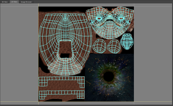

The UV View displays the UV texture coordinates for the active mesh in the 3D view as a 2D view. The UV View is useful for seeing how images that you paint on the 3D mesh appear as a 2D image in relation to the UV texture coordinates on the active polygonal mesh.

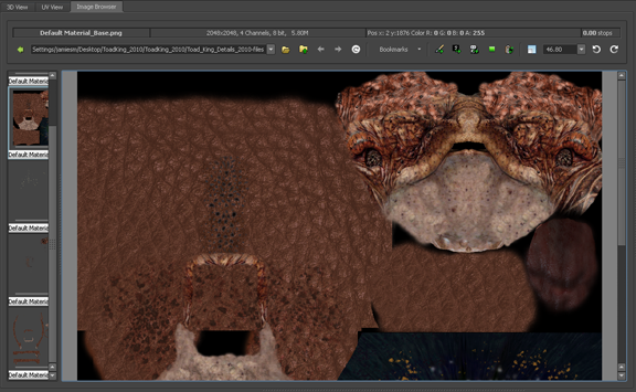

The Image Browser lets you view and select 2D images and textures from your local drive or network. Use the Image Browser to:
- View reference images
- Choose an image for a stencil. Select an image thumbnail and then click the Set Stencil icon on the Image Browser bar.
- Choose an image for a brush stamp. Select an image thumbnail and then click the Set Stamp icon on the Image Browser bar.
- View and evaluate 32 bit high dynamic range images (HDRI). The Image Browser lets you view the full range of values in these image types.
- View and evaluate the images you extract as normal or displacement maps.
For more information, see Image Browser window.

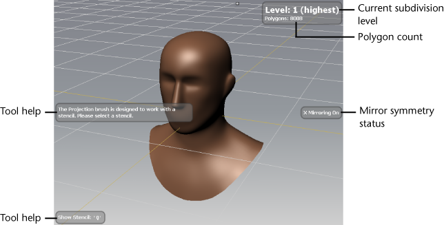

Heads-up Display
The Heads-Up Display (HUD) feature appears automatically in the 3D View and provides useful tool tips (hotkeys and feature usage, and so on) as well as status information (current subdivision level, number of polygons, and so on).
The HUD appears momentarily whenever particular actions are performed. You can control the display of the HUD from the Windows > Preferences menu.
