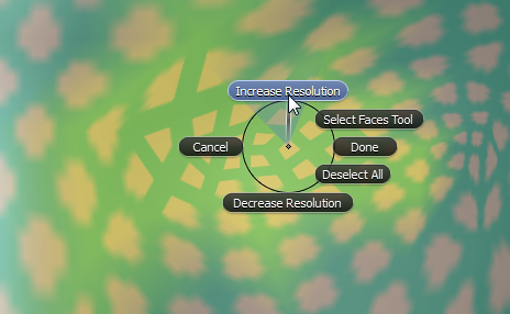

  1. Select UVs & Maps > PTEX Setup so that the PTEX Setup window displays.
  2. Select faces in the area where you want to increase resolution. (Hotkey: V)
    Tip: During PTEX setup, you can right-click the mesh and choose Select Faces Tool from the marking menu.
  3. Do either of the following to increase or decrease the resolution of the selected faces:
    • Right-click the mesh and select Increase Resolution or Decrease Resolution from the marking menu.
    • In the PTEX Setup window, click Increase or Decrease.
