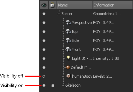

To hide specific objects
  1. Do any of the following:
  2. In the Object List, toggle the Visibility icon next to the objects you want to hide.
  3. Select Display > Hide Selected or Display > Hide Unselected. (Display > Show All or Show Selected display the objects again.)
To hide all but the active or selected object
  1. Right-click the object and turn on the Isolate toggle in the marking menu. (Or select Display > Isolate from the main menu bar.)
    All other objects in the scene are temporarily hidden until you turn off the Isolate toggle.
