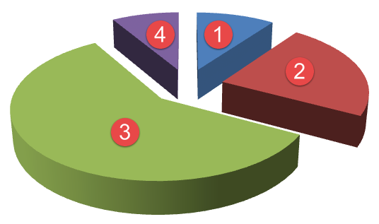

The phases of a typical injection cycle can be shown below. Actual portion size of the cycle elements will depend on the part and molding machine used.
- Fill Time
- Pack time
- Cooling time
- Mold open time
