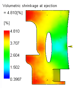

In this tutorial, you set up and run a Fill + Pack analysis on a 2-cavity tool of the panel. You evaluate the fill balance between the parts, the pressure to fill the tool, the shrinkage on the part, and the cooling time. This tutorial continues where filling analysis left off. You do not have to complete the filling analysis tutorial to complete this one, but review the steps. If you would like to review the filling tutorial click here.
