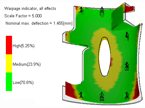

  4. Click Warpage indicator, all effects in the study tasks pane.
  5. Click plot properties icon (Results tab > Results panel > Plot Properties).
  6. Select the Deflection tab, set the Scale factor to 5 and Click OK. This setting will exaggerate the deflection five times so that it can be seen better.
    This result shows the relative magnitude of the warpage (out of plane change in shape) for the parts. Green areas are less than 80% and red areas are at least 120% of the Nominal max. deflection. The default value for Nominal maximum deflection is half the average wall thickness of the part. This result is shown in the result legend and is also listed in the Warpage Constraints warpage constraints icon (Results tab > Results panel > Warpage Constraints).

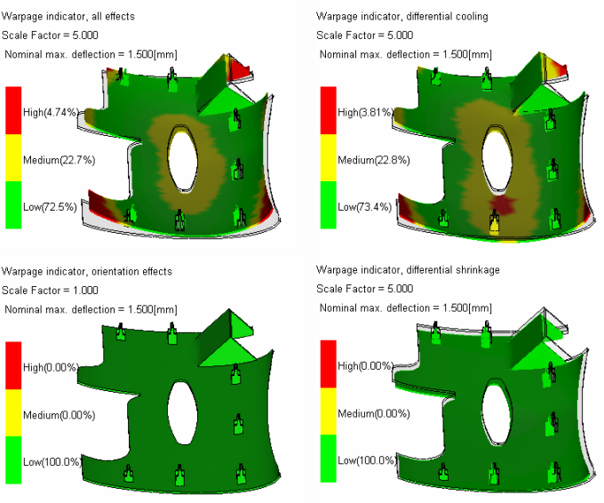

  8. Split the screen and display the other warpage indicators.
    Compare them to the all effects plot. The plot that looks most like the all effects plot has the greatest influence on the warpage. In this case, differential cooling is most like the all effects plot.
