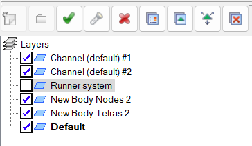

To enable a disabled Show Min/Max command
This information is valid only for those results that ordinarily support the Show Min/Max, such as the Fill Time result, but where the Show Min/Max has been disabled because of 1D beam elements in the runner system.
  1. Place your runner system on a separate layer (see related pages at the bottom of the page to learn how to do this).
  2. Hide the runner system layer.
    hide layer
The Show Min/Max command is activated and you can examine the data for the rest of the model.
