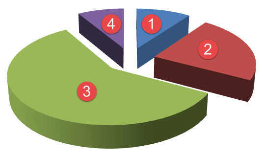

The phases of a typical injection cycle can be shown below. Actual portion size of the cycle elements will depend on the part and molding machine used.
cycle time phases
  1. Fill Time
  2. Pack time
  3. Cooling time
  4. Mold open time
