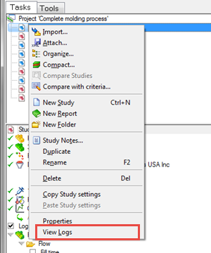

In order to improve the workflow, and save time, particularly with large models, you can view the study log of a study in an open project, without opening the study. There are different ways to access the analysis logs without having to open the study file:
  • In the project tree, hover over the study of interest, then click the right mouse button and select View Logs from the drop-down menu
    view logs browser
