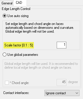

To mesh a CAD model using auto sizing
Auto sizing does not overwrite already defined local edge lengths and chord angles.
- In the Layers pane, select the CAD body layers to mesh. Only the visible model layers are meshed.
- Click
(Mesh tab > Mesh panel > Generate Mesh) - Click the CAD tab and ensure that Use auto sizing is selected
- Click Mesh, to launch the Simulation Compute Manager.
- In the Simulation Compute Manager, select the solve location, then click Launch.
Note: You can adjust the edge length through a Scale factor.
