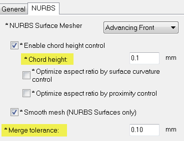

The chord height is used when calculating the edge length around a curve for an *.iges format. The edge length is shown by the distance 1 - 2, while chord height is represented by the distance 3 - 4 the cord length. By default the maximum chord height is 0.1mm.
When changing global edge length, the chord height value automatically changes too to reach 5% to 10% of the global edge length value. The chord height may need to be changed manually for:

Merge tolerance
By default the merge tolerance is 0.1mm. This parameter allows the software to create surfaces by merge face edges separated by less than the specified value. The *.iges format only provides a set of individual surfaces that are not connected. The merging of the faces forms a watertight body that is required for analysis.
Note: To personalize the Merge tolerance , click
(Mesh tab > Mesh panel > Generate Mesh). Select the NURBS tab and enter the appropriate value.
