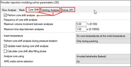

Powder injection molding includes three new features with this release:
  1. Core Shift analysis
  2. Venting analysis
  3. Solver API support
To access these features, ensure that you have selected Powder Injection molding as your molding process. Click (Home tab > Molding Process Setup panel > Process Settings). Click Advanced Options, then click Edit associated with Solver parameters.
For each of these new feature enhancements, ensure that you enable the option using the checkbox at the top of the dialog.
