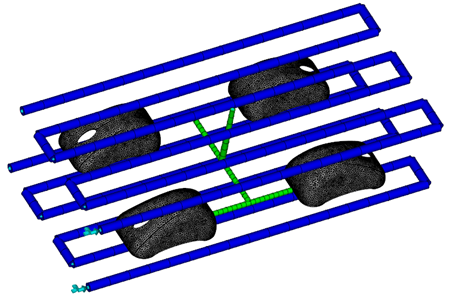

Quickstart Cool BEM tutorial: Create cooling channels
In this task, you will use the Cooling Circuit Wizard to create simple cooling channels.
Click
(Geometry tab > Create panel > Cooling Circuit).Select 10 mm as the channel diameter.
Enter 25 mm as the distance above and below the part.
Select X as the alignment direction.
Click Next
Enter 6 mm as the number of channels.
Enter 35 mm as the distance between channel centers.
Enter 50 mm as the distance beyond the part.
Click Finish.
