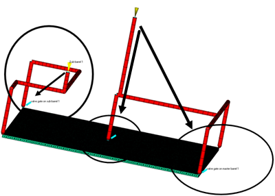

In the example below, there is a master barrel with three injection locations, and a sub-barrel with two injection locations. There are three valve gates; two on hot gates associated with the master barrel, and one on a hot gate associated with the sub barrel.

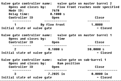

The valve gate instructions are reflected in the analysis log, so you can correlate the valve gate setup with the results of the simulation.
