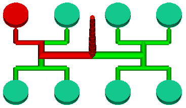

The figure below shows a naturally balanced 8-cavity tool. Only the geometry shown in red must be modeled. The remaining cavities are accounted for by occurrence numbers.
Figure 1: Occurrence numbers in a naturally balanced 8-cavity tool
Occurrence numbers in the figure above are defined as follows:
  • The sprue is unique and therefore has an occurrence number of 1.
  • The primary runner has an occurrence of 2 because the flow path splits in 2 at the base of the sprue.
  • The secondary runners have an occurrence of 4, and the remaining part of the flow path has an occurrence of 8.

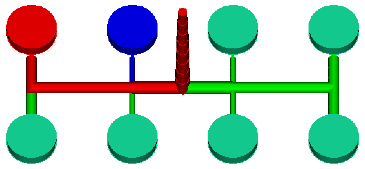

The figure below shows an artificially balanced 8-cavity tool. This runner system contains two distinct flow paths-respectively represented in red and blue-therefore the occurrence numbers differ from the first example.
Figure 2: Occurrence numbers in an artificially balanced 8-cavity tool
Occurrence numbers for the figure above are defined as follows:
  • The sprue-in red-is unique and therefore has an occurrence number of 1.
  • The primary runner-in red-has an occurrence of 2 because the flow path splits in 2 at the base of the sprue.
  • The secondary runners, gates and parts-represented in blue-have an occurrence of 4.
