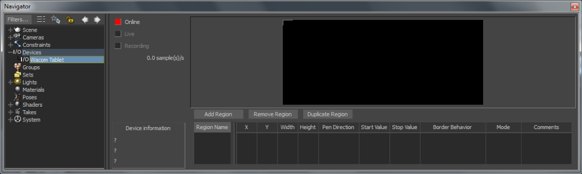

Adding the Wacom Tablet device displays the Device Settings and a representation of the tablet, referred to as the Virtual Tablet, in the Navigator window.
Device Settings for the Wacom Tablet device
Use this representation to divide the tablet into different regions for specific uses. For example, you can set a region to adjust the intensity of lights when dragging the pen left and right. Values are taken from the region and applied to an object connected through a Relations constraint.
Each region is shown as a white outline and the region’s properties display in the Regions table. When the pen is dragged or pressed in a region, its outline displays in red. The location of the pen is shown using gray crosshairs. When the pen makes contact with the tablet, the crosshairs are drawn in red.

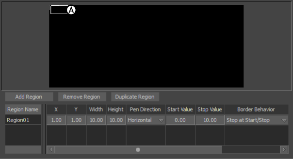

Adding a Region for a Wacom tablet
To add a region for a Wacom tablet:
  1. In the Wacom Settings, click Add Region.
  2. Select the added region in the Regions table, then set up the selected region using the fields in the Regions table.
    Wacom Tablet settings A. Added region
    When you add a region, it is automatically named, numbered, and drawn in blue. Its name cannot be changed.

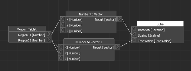

The Wacom Tablet device can be used in a Relations constraint to drive the position, scale, or rotation of an object. It can also be used to control animation such as blinking eyes, eyebrow movement, or other facial expressions.
For example, the following figure shows the Wacom Tablet device used to scale and rotate a cube. Region 1 controls the X rotation and Region 2 controls both the X and Y scale. Separate Number to Vector converters change the Region 1 and Region 2 values into vectors.
Wacom Tablet device in a Relations constraint
To use the Wacom Tablet device in a relation, drag it from the Asset browser to the Relations settings pane. It is automatically added as a Sender because it cannot receive data.
Each connector in the Wacom Tablet device corresponds with a defined region. You can add and remove regions after the Wacom Tablet device is added to the Relations settings.
