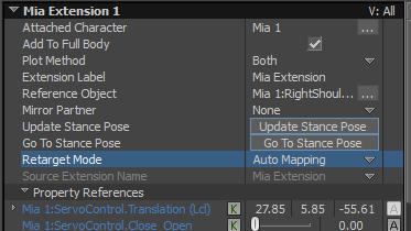

Retarget extension animation using Auto Mapping
  1. In the Character Controls window, set the following:
    • Character to the target character.
    • Source to the character with extension animation you want to retarget.set the target and source characters.
  2. In the Navigator, under Character Extensions, select the target extension.
  3. In the Properties tab of the Resources window, select Retarget Mode and Select Auto Mapping from the list.
    The source character extension's transformation values are automatically mapped to the target character extension. You can view these source properties in the target extension in the Navigator pane under Retarget Properties.

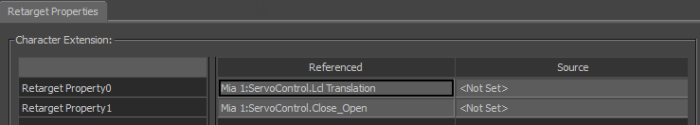

Retarget extension animation using Manually Assign
  1. In the Character Controls window, set the target and source characters.
  3. In the Properties tab of the Resources window, select Retarget Mode and select Manually Assign from the list.
  4. In the Navigator, select the source extension.
  5. In the Properties tab of the Resources window, click the lock icon to lock the source extension's Property settings.
  6. In the Navigator, select the target extension.
    In the Retarget Properties, the Character Extension table indicates that the Source values are not set.
  7. To map the source extension's animation, drag the source extension's Translation values from the Properties tab into the appropriate location under Source in the Character Extension table.
